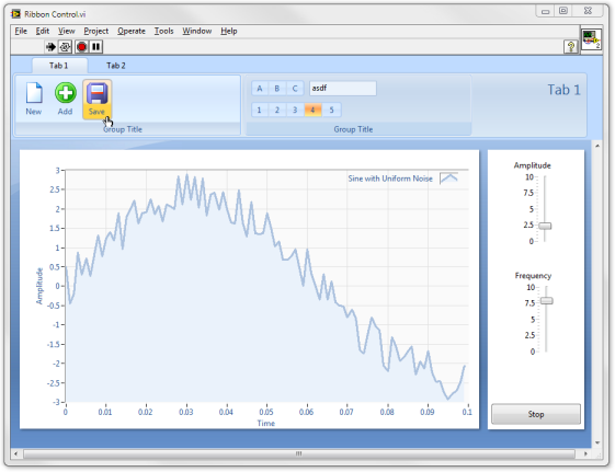

Has anyone looked into implementing the "Ribbon Toolbar" in the LV apps with any luck?  I'm starting to look into this and I'm going down the road of incorporating this through .Net.  I'm not a .Net expert by any means nor am I necessarily interested in copying the look and feel by recreating the graphics in LV (although that would be serious kudos to someone that has done that), rather tying into the Windows theme.  There are quite a few examples using C# and WPF (Windows Presentation Foundation), but I haven't come across anything on how to get this started in .Net/LV.

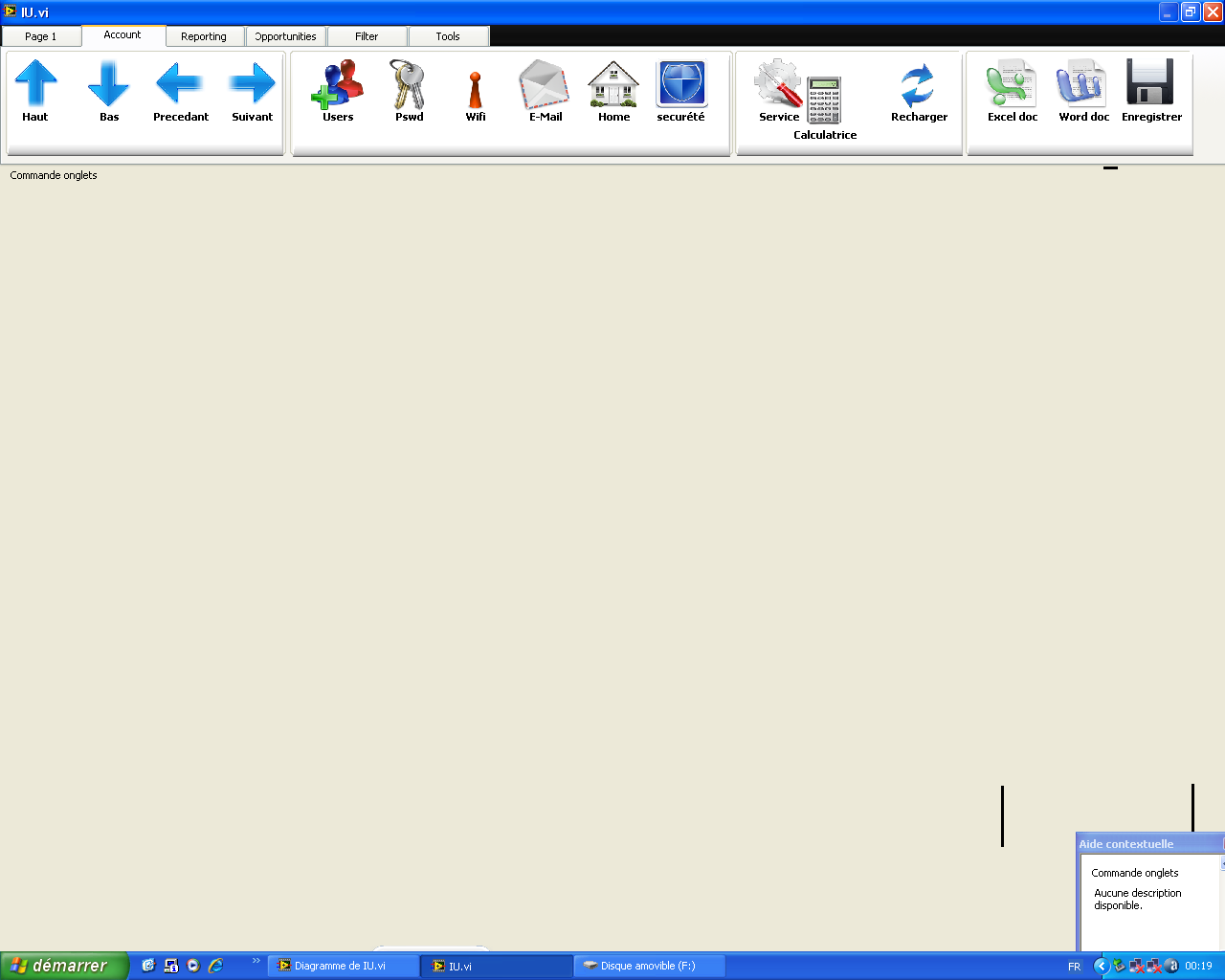

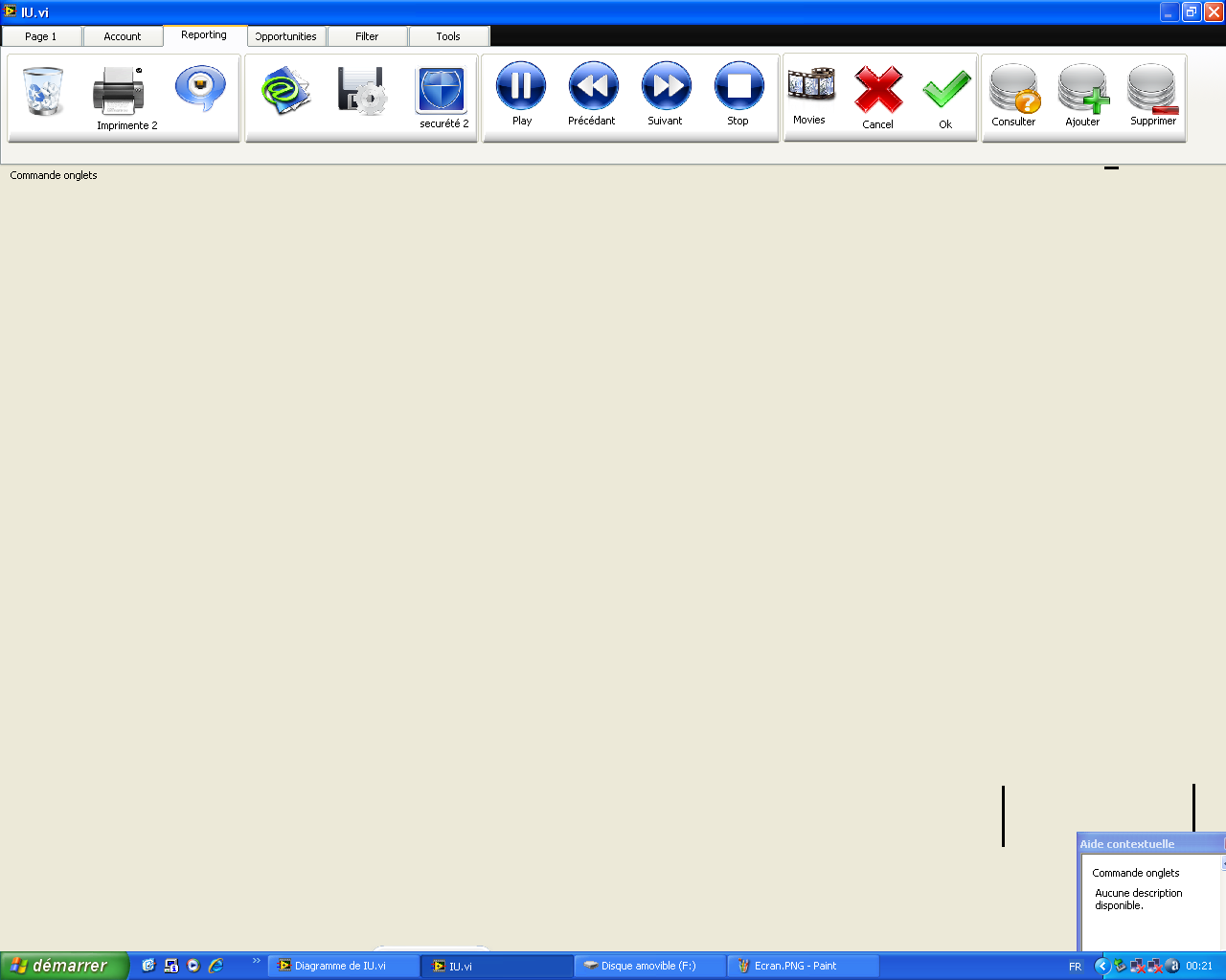

Nice work.  I have held off doing the detailed UI design like yours because was really curious to find out if it is possible to achieve a .Net/WPF implementation.  Obviously the hardest part is getting all of the initialization stuff (namespaces, etc) figured out and figuring out how xaml code maps to the constructors/properties/methods accessible through LabView.  I am still very interested in trying to get the .Net implementation working, but what you have shown in your mock up as a "Office 2007-like" application is very nice.  I feel that as more and more people begin switching from the Office 2003 to 2007 products that being able to implement the ribbon in commercial apps will be very intuitive (even if it may not be right now).  So, I'm not giving up yet.

Trés impressionnant, et joli travail! Chapeau
