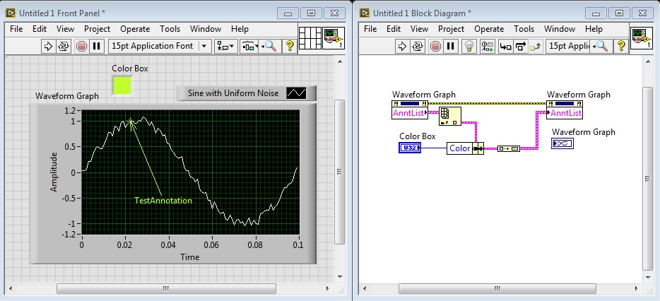

You can change the colour, this little VI worked fine for me:
But to have the annotation appear in the same place on the UI for multiple tabs would mean creating an identical one on all your plots. However, that's not hard as they are programmatically settable. You can create one annotation definition and set the "AnnList" property on each graph in each page of your tab container.
Going back to your original problem, sounds like you have a floating string control over your tab. That's always been known to be hard on the LabVIEW graphics engine, and will slow down your refresh rate/increase CPU usage.
Consider:
1. Multiple strings (one per tab, in the same place, with the same content)
2. Cloning the annotation properties across all graphs.
Note: There are peculiarities when setting annotations programmatically, especially if you replot the graph content - the annotation can disappear. Take care when setting these.
