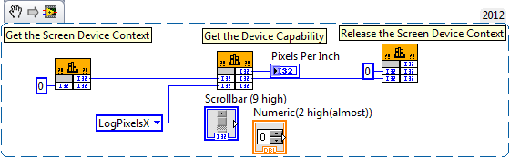

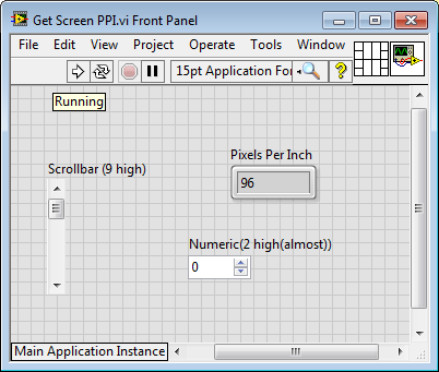

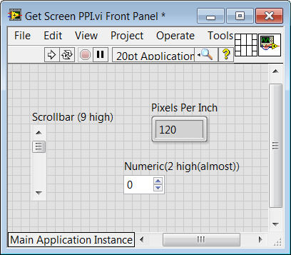

I checked and twips ar outdated, however you can query the pixels per inch of the screen as this is what the accessibility functions set. The heights and width of the buttons does change with the ppi as well as all of the font sizes. The actual controls do not seem to change size though. I have included the VI to find the ppi and put extar controls on its front panel to view the changes in button size. Also included are the three images I took of the front panel at 96ppi, 120ppi and 144ppi.
By the way ppi is obviously not ppi as pixels on your screen don't change in density, so changing ppi actual changes the size of the inch, so much so SI units.
