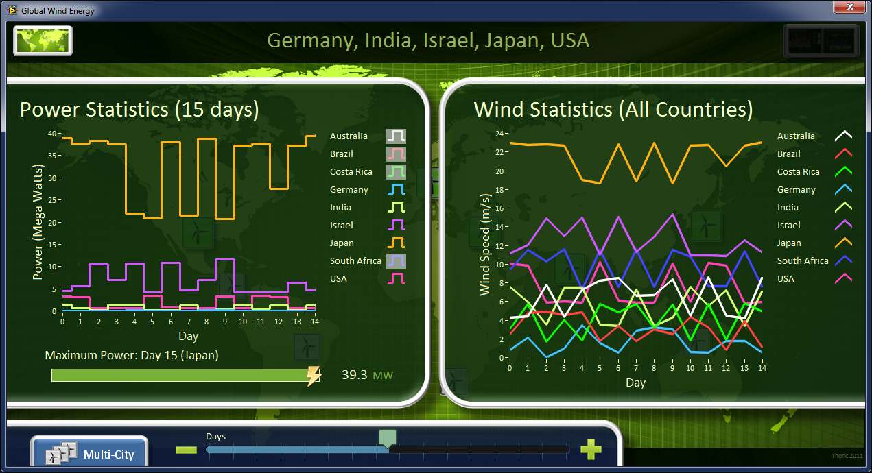

Another unanticipated use case, perhaps, is the grey box that appears behind the legend entry for hidden plots in graphs. In my User Interface entry I programmtically chose which plots to show, and I emply a lot of control overlays in this VI. For the plot lines that are hidden, you are presented with an ugle grey box behind the plot line symbol.
https://decibel.ni.com/content/servlet/JiveServlet/showImage/102-19921-32-25674/plot_multi.jpg

Yes, that's another "gray out" rectangle. What would you like it to look like? The same as when the plot is visible?

No matter what solution is used I would expect the background to remain transparent, as set. Anything other than that is effectively a 'highlighting' of the item.
I think, in this case, the plot line and plot label text ought to be 'disabled', which would most likely involve making their foreground colours >70% transparent.
Thoric (CLA, CLED, CTD and LabVIEW Champion)
Message 7 of 10
(5,134 Views)
A mock-up of what I mean by making the label and plot line ~70% transparent on, for example, India's plot:
