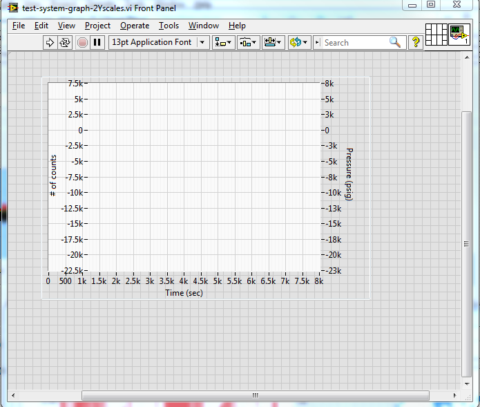

I am using a waveform graph from this palette.   I added a second Y-scale.  The first Y-scale needs now to be moved to the left of the X-axis 0 (so not inside the plot) like we normally see, but I can't seem to find a way to resize the graph or otherwise move it so that it is not inside the plot.  Any help here is appreciated.  I am thinking it is something obvious.
I don't seem to be able to attach the VI, so I am adding a screenshot and can send the graph via email for anyone to take a look at.

Select the graph. Choose the Edit menu and select Customize Control. A Control Editor window pops up. Choose the Operate menu and select Change to Customize Mode. You should now be able to select the plot are and resize it. When done, close the Control Editor window and select "Yes" to Replace the original control in the first dialog and "Don't Save" in the second dialog.
BTW, can you tell me how you added the second Y-scale? When I choose Duplicate Scale and Swap Sides, the scales are properly outside the plot area. Thanks.

Thanks for your reply.  I did the normal duplicate scales, but I think what messed this up was that In my LabVIEW.ini file, I have the setting:  "EnableAutoScales=False"   which I have placed there to keep the plots from resizing themselves.   Swap sides was grayed out so I had to change the ini setting to "EnableAutoScales=True" to ungray the option for Swap Sides.  How did I stumble across this?
See   http://forums.ni.com/t5/LabVIEW/Multiples-scales-swap-sides-problem-LV8-5/td-p/1030537/page/2
I am thinking that the initial scale showing up on the interior might not have happened if I had "EnableAutoScales=True" set from the start.  I just tested and verified this so thanks for bringing that to light.
Should be all set now.
