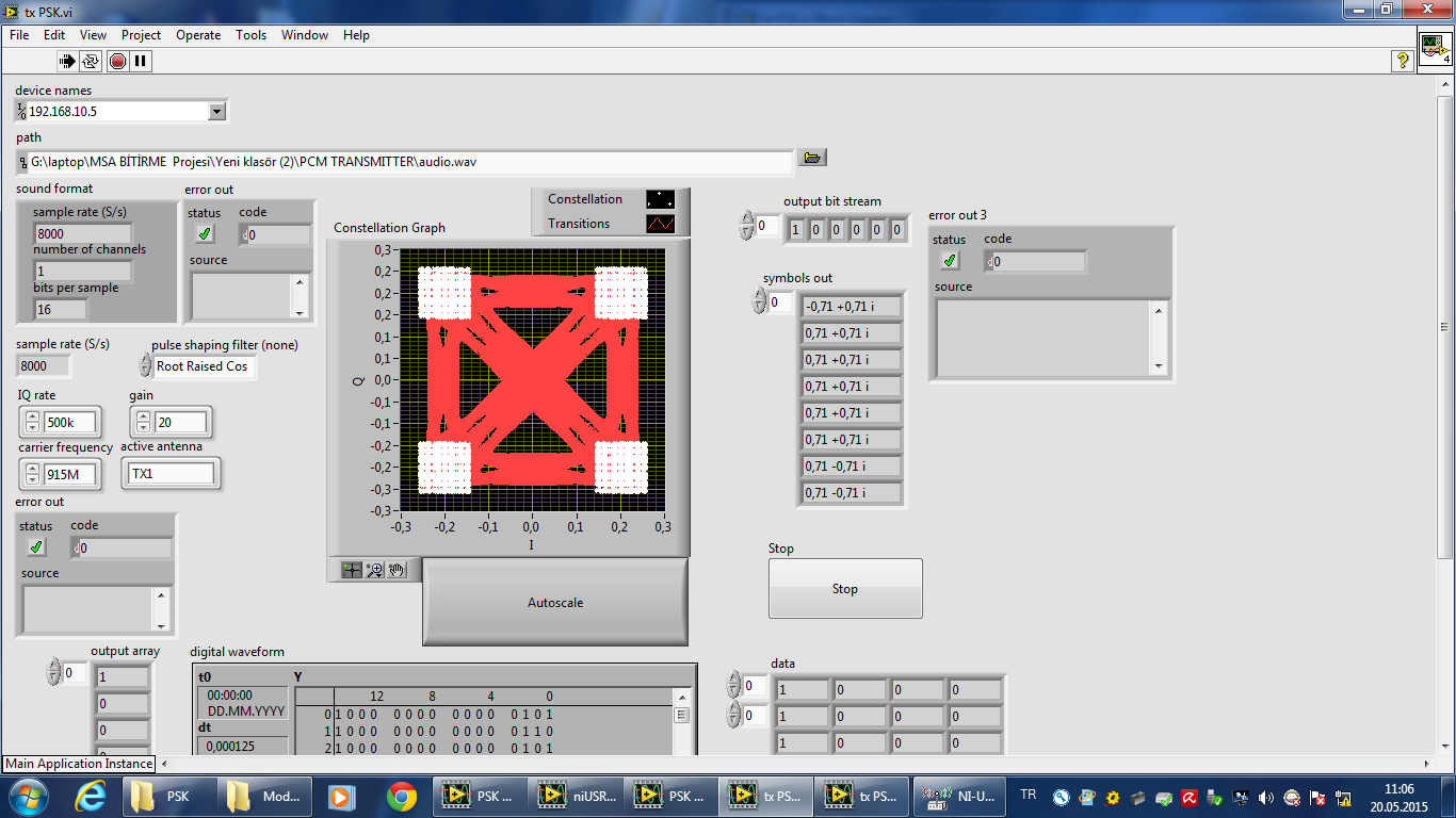

I get bit stream for modulation as you say and how can I implement this to niUSRP EX PSK Tx.vi.
Message 14 of 16
(3,904 Views)
It looks like you are one the right track.  The key things that I see are missing are the NI-USRP VIs.  Make sure to open the mod_Continuous BB-PSK generation.vi in the example as well.  There is some extra functionality happening in that VI that will help you understand the programming flow.
Message 15 of 16
(3,886 Views)
I found QAM transmitter and receiver examples and I adapt QAM transmitter to PSK transmitter.I just changed QAM modulation vi's with PSK modulation vi's.I didn't adapt receiver part so I used niUSRP EX PSK Rx in the modulation toolkit examples.I observed that Constellation Graph of transmitter matched with receiver's Constellation Graph.But I have some problems.Firstly, I run tx PSK.vi without highlight execution when NiUSRP Write Tx Data didn't give error but run with highlight execution gave error.Secondly,I want to listen the received signal after the demodulation.I think that I did something wrong in the receiver part too.
