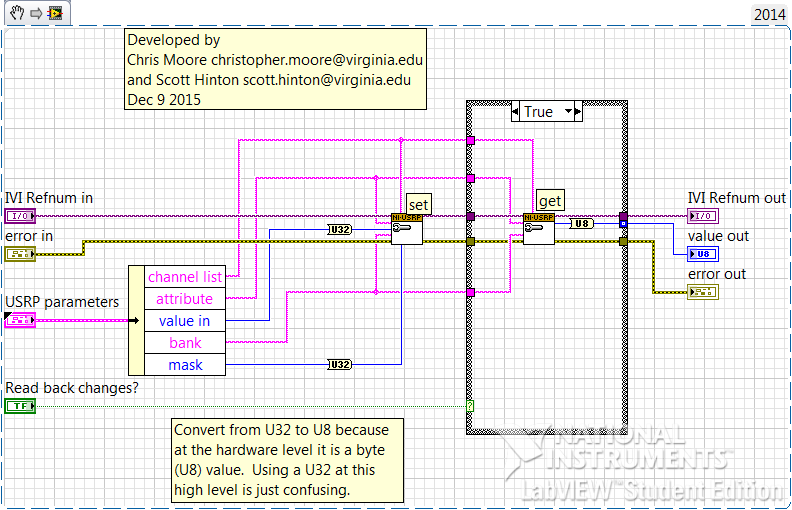

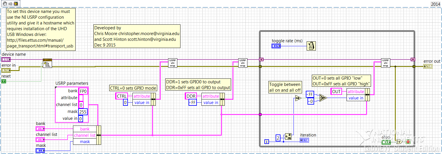

RDFer is a student of mine in the capstone program at the University of Virginia ECE department, he came to me for help today and here is the working solution we came up with:
the USRP attr wrap VI looks like this:
The commands that we used can be found in the GNU Radio Manual here (API for UHD):
https://gnuradio.org/doc/doxygen/classgr_1_1uhd_1_1usrp__block.html#a643ecdd188565f6bfeca75a70e625ee...
And another thread dealing with this problem at Ettus (but not in LV):
http://lists.ettus.com/pipermail/usrp-users_lists.ettus.com/2015-August/015468.html
