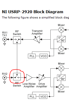

Hi, Erik. I have seen the AOA demo, and I am curious about the receivers where the two antenna connectors are used as RX (one by wire while the other is wireless). However, when I go to see the NI USRP-2920 Block Diagram, I think the RF Switch can only switch to one direction, is that right to use these two connectors as RX at the same time?
And can the two connectors of  USRP-2921 be used as RX at the same time?(In my lab, I only have USRP-2921)

The AoA code only received from channel rx1 and never the second one by wire using the switch. The students were clever and treat the switch as an attenuator since it has leakage. You could accomplish the same using a T junction on Rx1 with 30db of attenuation in the cabled path.
