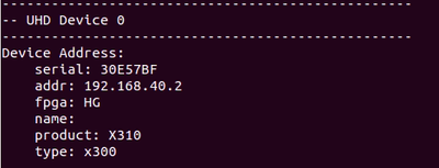

if you want to check the image please use the following steps:
  • open "command prompt window" - Win logo + R and type cmd
  • locate USRP utilities folder and copy the address - C:\Program Files (x86)\National Instruments\NI-USRP\utilities
  • change the directory in the command prompt window- cd C:\Program Files (x86)\National Instruments\NI-USRP\utilities
  • run uhd_find_devices

Could you please share more info? What OS are you using (driver version, connection type, programming environment...) ?
