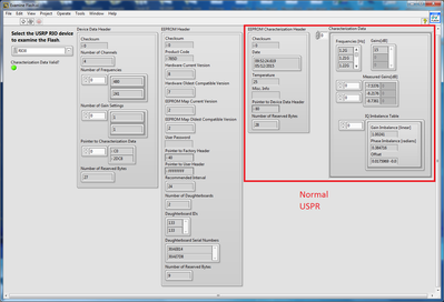

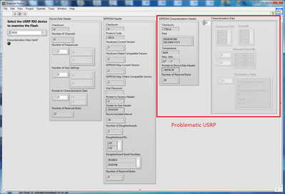

I have two USRPs, one works well and the other one have some problem - the system cannot properly recognise the USRP. Also the problematic USRP cannot load the FPGA image from flash. In addition, I can not update the FPGA firmware of the problematic USRP.
I tried to use "examine flas.vi" in LLB manager to check the difference. I notice that the EEPROM characterisation data in problematic USRP are not right (shown in the pictures below).

As you have found, the flash was corrupted. Please contact NI Support for further assistance on this issue:
https://sine.ni.com/srm/app/getassistance
