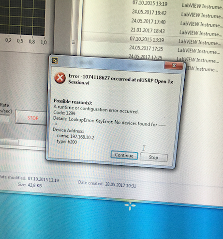

I am working with a niUSRP 2901, and when I try to run example vi's which is provided by default I get the following error at the screenScreen Shot 2017-06-06 at 11.44.20 PM.png
Can anyone help me with this issue please?

Hello Zeki,
This is an interesting situation. With a 2901 (or b200), we shouldn't have network capability because those are USB only. I have a few questions to characterize this system.
1. Does the USRP appear in the USRP Configuration Utility? Could you post screenshots of its status?
2. Which version of niUSRP are you using? Which example are you trying to run?
3. Have any other USRPs worked on this same computer? Any other 2901s?

Typically, the 2901 and 2900 show up in the configuration utility as "ni2901" or "ni2900". I recommend putting that rather than an ip address into the box.

Hello Daniel,
thanks for your help,
1- I will do it when I will work again,
2- we are using 2901 and trying to run "niUSRP EX QAM Tx.vi".
3. Yes we have two 2901's and we have worked with both in the same computer,
I will let you know about the USRP configuration utility when I go to the lab again,
