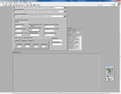

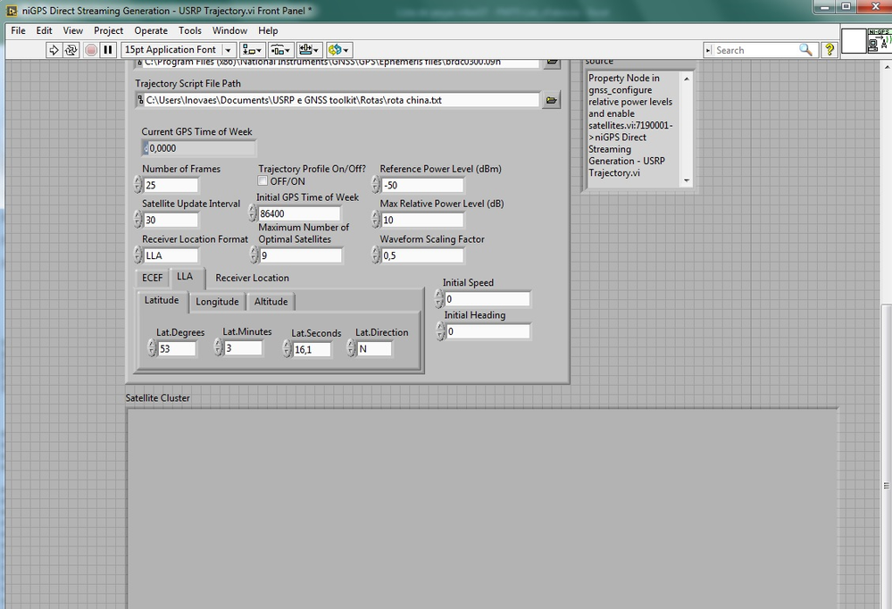

Thanks for your help. Still, I couldn't run the trajectory vi. Everytime I tried to run it, the Satellite Cluster disappears from the Front Painel, and the following message error pop up: error trajectory vierror trajectory vicluster disappearedcluster disappearederror subvierror subvi
Do you have any idea why this could be happening and how can I solve it?

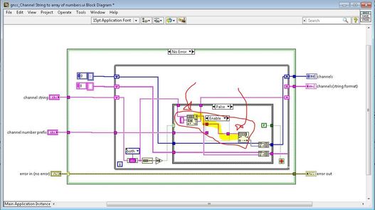

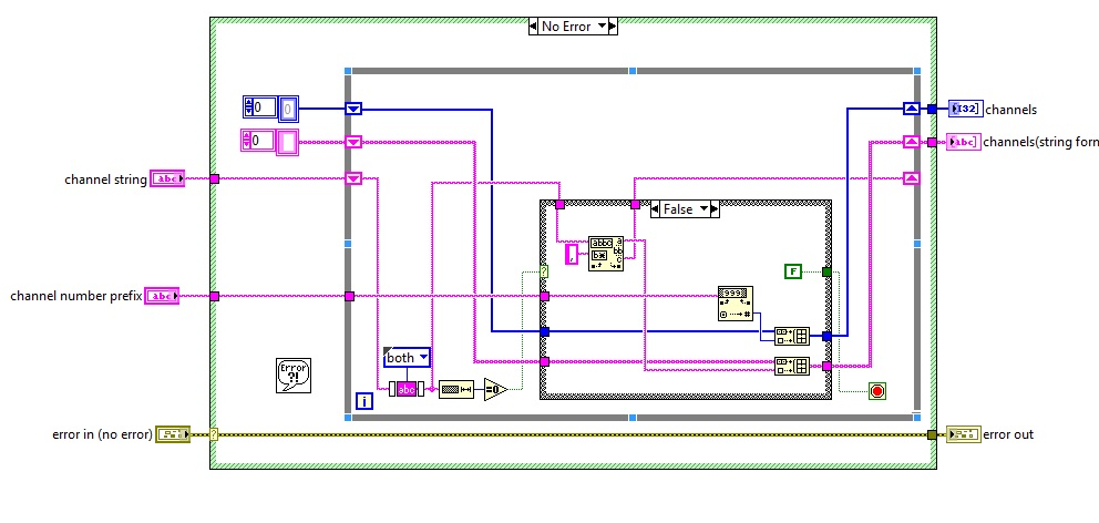

Satellite Cluster doesn't disappear from the Front Panel, the vi "gnss_configure power levels and enable satellites.vi" just set which controls are visible based on satellite list. However, there is an error in the suVI "gnss_Channel_String to array of numbers.vi" inside the "gnss_configure power levels and enable satellites.vi". The block diagram uses a Match Pattern function to search for a prefix "G", in Optimal GPS Satellites niGPs property output (9,12,15,18,22,26,27,28). but it doesn't exist. So the result is an invalid object reference due to an array of 0s from the "channels ouput" of the "gnss_Channel_String to array of numbers.vi" instead of an array of satellite channel numbers to match the niGPS_Optimal GPS Satellites output. A workaround would be deleting or disabling the second match pattern function as below picture:
Remove or Disable the second match pattern function.Remove or Disable the second match pattern function.
Any quesitons let me know.

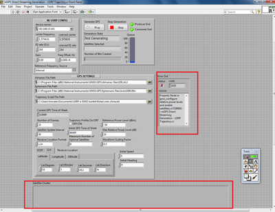

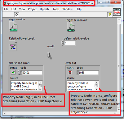

Thanks again. I deleted the second Match Pattern as you recommended, but still it doesn't work. The following message error appears: "Property Node in gnss_configure relative power levels and enable satellites.vi:7190001->niGPS Direct Streaming Generation - USRP Trajectory.vi" and the same thing happens with the Satellite Cluster.
I have tried to debug it, but after I run the vi (and it fails), the subvi "gnss_configure power levels and enable satellites.vi" becomes "blocked" after a while, and I can't change anything anymore (so I have to close the USRP Trajectory in order to "recover" the Satellite Cluster and replace the "gnss_configure power levels and enable satellites.vi" if I want to change anything). Also, despite the error out from the main vi indicates the error is inside this subvi, its error cluster doesn't indicate anything - in fact, even when I put some "Simple Error Handler" inside the "gnss_configure power levels and enable satellites.vi" and run the USRP Trajectory.vi, none message from the error handler pop up.
Any ideas?

vi without second Match Patternvi without second Match Patternerror messageerror message

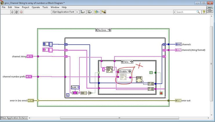

After you delete the second Match Pattern, as you already done, you must connect the output "Before Substring" of the first Math Pattern to the string input of "Decimal String to Number" function, not the "channel number prefix" control output as you've done. See image:
When you run the main VI, the subvi "gnss_configure power levels and enable satellites.vi" is unable to edit because after called it is reserved, or load in memory. To edit it without closing the main vi, you can select the option "Change to Edit Mode" from Operate menu.
