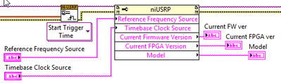

Unfortunately I no longer have 1.0 installed on my machine, but to get the trigger working incorrectly with 1.1, you need to set the time as well as configure the trigger.  Since the trigger is configured based off a given start time, it is important to zero out the time value of the onboard device timer.  If you don't do this, there is a possibility that it will not start at zero and the value that you specify for the start trigger time may have already passed.  Here is a screen shot of how to set this up:
As I mentioned, I don't currently have a system to check how the trigger was set up before, but using these 2 VIs you should take care of the error. If you are still having issues let me know and I'd be happy to help.

I do it slightly different , i set the trigger time first then later in the diagram just before start transmit i set the clock to 0 time.
