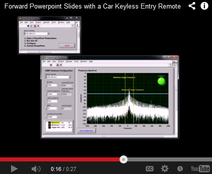

Petroldevil,
Have you looked into the subVI for the Forward Powerpoint Slides? You set an upper and lower frequency threshold and then a trigger level. Might require less work to start from this than from a blank VI.
