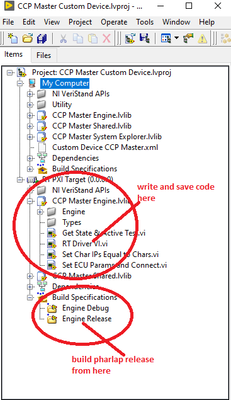

I believe I have come accross this before when trying to deploy custom device code to PharLap targets
You need to create the RT driver code under the PharLap target which is present when you create a custom device project using the template and build your Engine Release from there too, otherwise you are building a program to run with windows vi's rather than real time vi's and expecting it to run on a real time target
