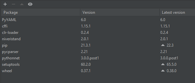

virtual environment for reference
These were all defaults.
I rolled back to 3.0.0 and retested and still got the error.  Then I tried to go back to 2.5.2 except when i try to install I get
