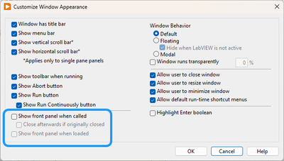

Have a question for you.  How were you able to view the front panel of the custom device?  Did you hook a monitor up to the target and load front panel when called?
(633 Views)
Kindly please don't ask a new question on an old thread. Please start a new thread instead.
Debugging by showing front panel only works when
  • You are debugging configuration library.
  • You are deployment engine library on localhost Windows target.
