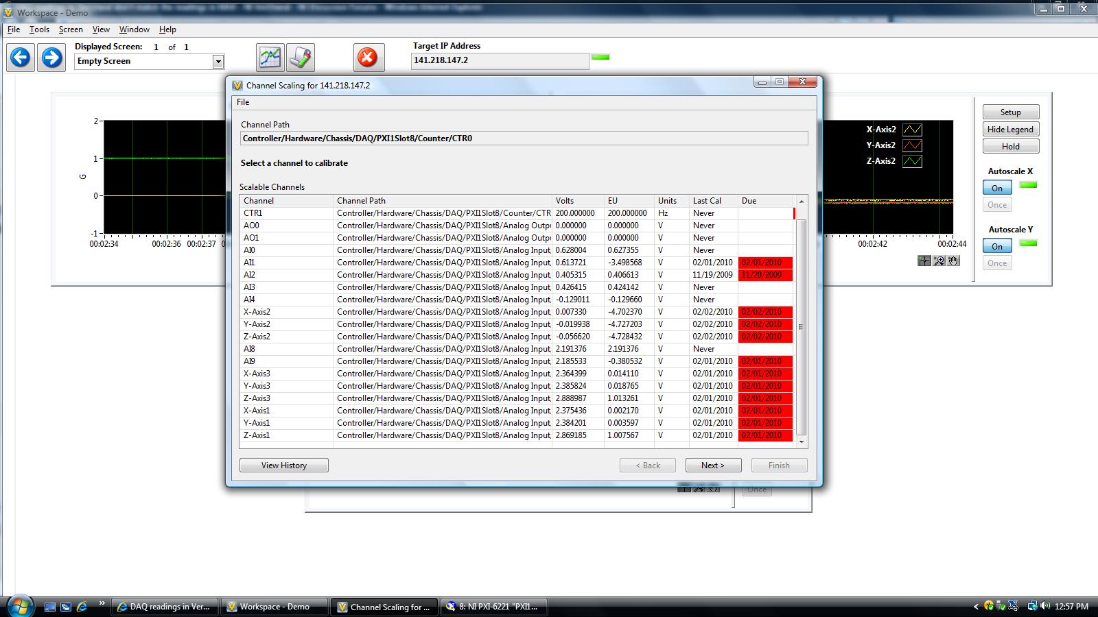

 The first screenshot is of system explorer with MAX in the background showing how the DAQ is configured. I changed the names of the channels so that the graphs in Veristand would label which channels were showing data from which axis and which accelerometer. X-Axis1 is connected to channel AI13, Y-Axis1 is AI14, Z-Axis1 is AI15, X-Axis2 is AI5, Y-Axis2 is AI6, Z-Axis2 is AI7, X-Axis3 is AI10, Y-Axis3 is AI11, and Z-Axis3 is AI12. The second screenshot is of the channels and scaling. I scaled each axis to give units of g, and the one that's giving me trouble is X-Axis2/Y-Axis2/Z-Axis2. The votages it's recording for the second accelerometer are not the same as the voltages for the 1st and 3rd. The other channels that were calibrated were for something else that's no longer connected and can be ignored. I also wanted to mention that each accelerometer is identical. There is nothing different about them or the way they are connected. Now I am new to Veristand and all of these instruments, so I wouldn't be surprised if there's something I'm doing wrong. Hopefully this will be enough to see what's wrong.

The only thing I can think of right now is your channel settings may be different for X2 and Y2 than the rest of the channels. The screenshot only shows the configuration X1 which doesn't have a problem, so I couldn't tell.
