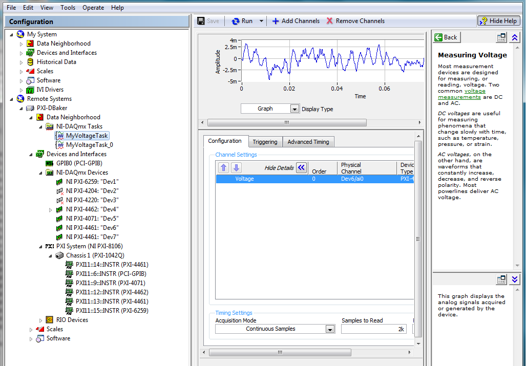

I desperately need some help with some application i’m working on. I’m trying to read some accelerometer measurements into NI Veristand but coming up with an error all the time during the deployment stage to the real target which i have atttached. I can’t quite figure out what to do about it. I’m using a real-time device with a PXI-4461 module. I have checked that i can read all sensor measurements in MAX as attached. The error message is as follows:

In terms of your application, set a sampling clock to a sampling that isn't 'On Demand' (eg, continous, or finite) and this will resolve the errors your are throwing.I have attached a screenshot of the acquisiton modes that can only be selected for this card.
