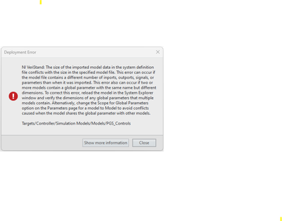

I have a very simple example of a Simulink model that includes a subsystem. It has a mix of Simulink/VeriStand Input and Output blocks as shown below. However, when attempting to deploy the model, I get the following error:
NI VeriStand: The size of the imported model data in the system definition file conflicts with the size in the specified model file. This error can occur if the model file contains a different number of inports, outports, signals, or parameters than when it was imported. This error also can occur if two or more models contain a global parameter with the same name but different dimensions
I have tried following this knowledge article with no success Error -307702 When Deploying VeriStand System Definition to Real-Time Target - NI

Thank you ZYOng for taking the time and attaching the files. I can confirm the model you built also work on my setup. After reviewing the example model I put together, I can see that I'm doing something that doesn't make much sense. Effectively, its the same as what is in the image below. I added a VeriStand Output block in parallel to Output 2 within your sub-system model. This then produces the same error as I was seeing previously. There's no actual reason for me to configure the outputs like this. Being somewhat new to VeriStand, I was slightly stumped with regards to the error message I was getting.
