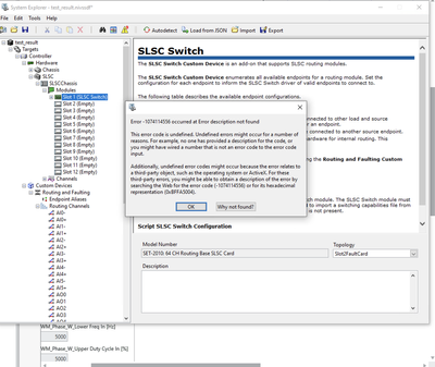

I have an issue utilizing SLSC module called SET-2010 (3rd party module).
Here is my environment:
Veristand R3 f1. SLSC connected via local network. SLSC Chassis have several SET-2010 modules.
Steps to reproduce:
1. On Veristand, create a SLSC chassis under Hardware/SLSC. Configure its IP Address.
2. Go to SLSCChassis/Modules, then select 'SLSC Switch' from dropdown for the slot that has SET-2010 inserted.
3. Click 'Slot x (SLSC Switch) under Modules
4. Click 'Autodetect' menu item. You will see that Model Number text box filled with "SET-2010: 64 CH Routing Base SLSC Card" and the topology dropdown shows 'BaseCard'
5. So far so good
6. Now change the topology value to 'Slot2FaultCard'. I see an error dialog showing the following:
The error does not explain anything about what went wrong. I followed the steps for other modules in the same chassis but the result was the same. Any advise is much appreciated.

I have responded to this on the original GitHub issue.
