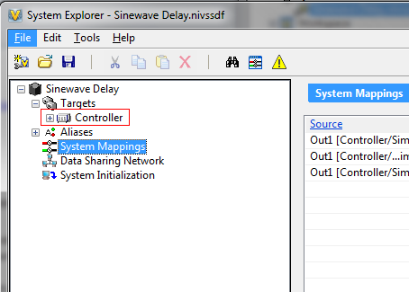

Hi Claudio,
I found out that argument provided to the Get Parameters.vi.
Needs to match the target defined in the SDF:
I hope this extra detail helps!

Hi Dustin,
I was thinking that is the point and used "Model Host" as input.
Do you believe that may be a problem to have spaces in the names?
Cheers,
