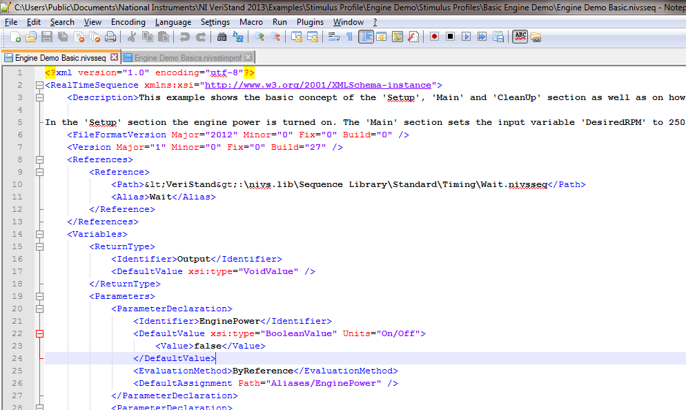

After collaborating with my internal resources, currently there isn't a stand-alone tool to view NI VeriStand Stimulus Profiles or RT Sequences as found in TestStand. We tried to use the Stimulus Profile Editor.exe with the associated config file as a stand-alone application but we were not successful due to the dependencies of the exe to VeriStand.exe
As an alternative, you can use Notepad++ to view .nivsseq and .nivsstimprof files since they are saved in XML format:
Would this be a viable option for your code review requirements? Let me know your thoughts.
