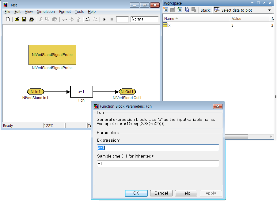

"Gain" and "Constant" etc basic blocks are working quite well with as parameter on veristand when I configured value of block to Inline veriable.(Value is "x")
However, Fcn(Function Block) and Subsystem block with mask are not visible on Veristand even thought I configured value to inline variable.
Do you know that Veristand do not recognised Simulink block?
For example, Veristand is recognize "x" to gain parameter when I configured value of gain block to "x". also, "x" is inlined.
but, If i configure expression of Fcn(Function block) to "x+1", Veristand didn't recognize and not visible "x" as parameter. "x" is also inlined too.
Please see below for reference.

Hi
We've been able to reproduce the behavior you are experiencing realshiner; however, the behavior is expected. Please note in MathWorks Help documentation under the Fcn topic, that the block's expression cannot be tuned in generated code. If you are not using the 'u' input variable, then it may be possible to tune that item at runtime.
