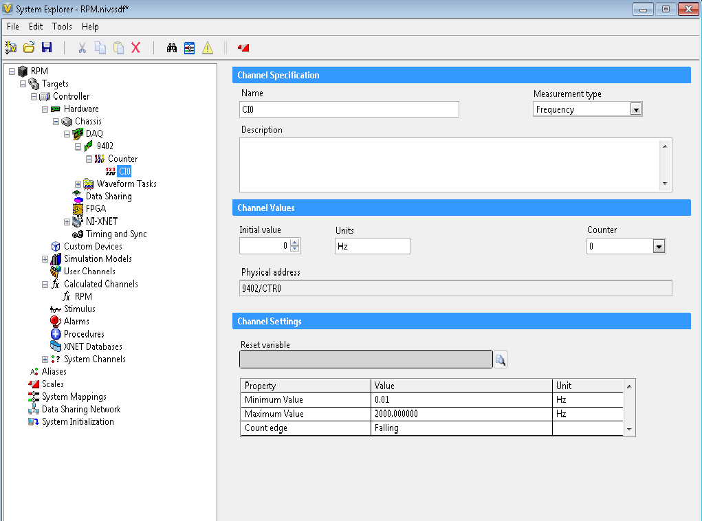

I am not sure if I have connected to a single counter.  as I mentioned in the previous post I am using NI 9402 cDAQ DIO LVTTL module do acquire my frequency input.
My min frequency was set to 0.01 and my MAx was set to 1000 Hz in the channel settings as shown below
I did change this min frequency to 1000 hz but it didn't help.

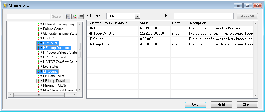

Within the workspace, select Tools: Channel Data Viewer.  That tool can display any channel in VeriStand so within there you should be able to browse to System Channels.  Some System Channels provide some feedback as to how your system is running.  Two important ones are HP and LP Loop Duration as they tell you how fast your loops are running.  If they are close or exceed your desired rate (e.g. 1,000,000 nsec HP Loop Duration and you are trying to run at 10 khz (100,000 nsec) then you have something wrong or too much going on to achieve that rate...
Message 8 of 16
(7,795 Views)
Thanks for the input.
The number I am seeing are whay above what you have described.

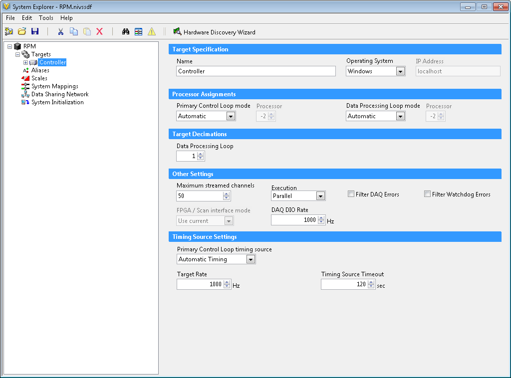

The test that I will be trying to run requires that my controller acquires and commands data at a rate of 1000 Hz perhaps this is causing the problem?
Tim
Message 9 of 16
(7,776 Views)
Your large HP Late Count means the main control loop is not completing within the timeframe you established (e.g.  1 msec ).  This matches with the HP Loop Duration which shows that loop is taking over 1.1 msec to complete.  I would start removing items from the system definition (you could start with the prime suspect, your RPM input).  If you HP Loop Duration and Late Count come in line, then you know it is just your RPM input that is causing the problem.  Assuming it is the RPM input, I would apply differenty frequencies to that input and graph the HP Loop Duration to see if there is any correlation between HP Loop Duration and input frequency.
