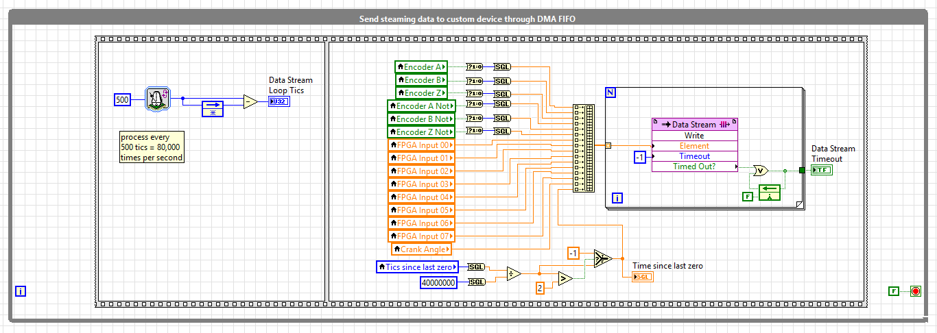

Ah but are the waveforms coming from the loop below that? Where it is sent to the custom device element that is accessing this?
The loop you have shown there is the data that comes in through the NI FPGA XML definition which is all single point timed I believe.
Below there is this datastream:
This is going to start as soon as the FPGA starts. There is nothing stopping it. This also means it won't wait for the DSA card either hence the lead time.
If this data also needs to be synchronised you need to make it start when the sample clock starts. If you put this look in a flat sequence structure then you can add a frame before that waits on the first sample clock pulse. I think this should just work if you put the wait for next tick in the first frame (outside of the loop, we don't want to time the loop, just wait on the start).

That makes perfect sense! I'm going to have our client test it, but I definitely think you're on to something here. Thanks for the help, and I'll come back here and mark your answer as the solution if this works.
