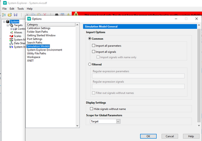

in VS2021 in the option window of the tool menu you can choose the scope of the Global Parametres. I think in earlier versions it was also possible.
(3,160 Views)
@thumble - Yes, there's an option for that in VS2018 as well. i tried both "Target" and "Model" scope with the same result.
It shouldn't make much difference anyway, as the parameter names are unique in this case.
