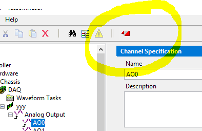

While in the NI Daq custom devices i can see this highlighted object

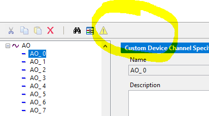

in the custom devices we produce we can't have that option
NotScalable.PNGand so it's impossible to use the "scales" feture on our custom tools.
