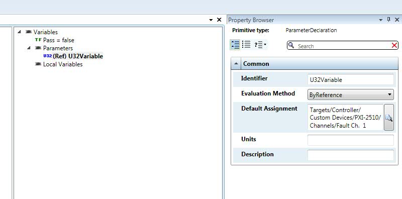

Hey Yesim,
From the stimulus profile editor you just need to add a parameter assigned to a channel in the custom device. This is done by dragging a variable to the parameters field in an RT sequence, and then selecting the channel you want to map to in the property browser on the right side of the screen.

Hello Kevin,
the unit of the switching states is a U32 variable?

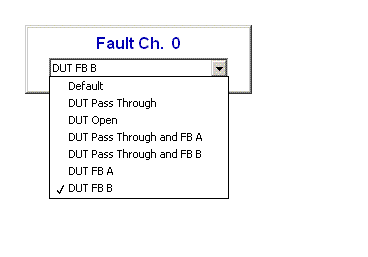

Switching states could be
This means that the variable "U32" represents the enum of the switching states, isn`t it?
