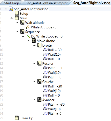

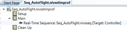

Tim,
I just need to get an event fired when a step launch and finishes. This event could only contain the step group, step name, state (running, done ; more pieces of information could be added).
A step could be define as every action listed in the stimulus profile editor. Here it could be 'Real-Time Sequence :Seq_AutoFilght.nivsseq' or 'While Altitude <3' or 'Roll=30' etc...
As it could be done by event, you could have a specific thread in charge of publishing such information and that would not impact (or only sligthly) CPU load and slow down RT execution.
Even better, this event generation could disabled (option) if its execution disturb the execution.
The stimulus generator looks like to TS too much to not giving basic TS functionnalities ! Smiley Tongue
