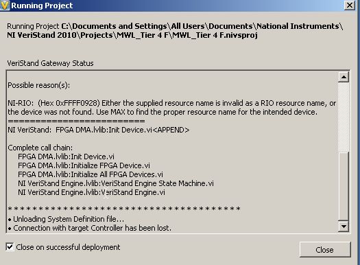

The project deployment on windows comes back with this error dialog.
Message 77 of 118
(2,290 Views)
I'm guessing your system definition has an fpga device added to it, and possibly other hardware as well that is not present in your windows OS. I'm just trying to see if the xcp/ccp device is executable on windows, so can you either make a new system definition or right click and disable the hardware in yours?
Stephen B
Message 78 of 118
(2,284 Views)
Sorry, i couldn't catch your stream of thought. I disabled the fpga card on project and the deployment came back with a broken vi error dialog, just like RT error.
Message 79 of 118
(2,279 Views)
no worries. So it appears the custom device files are simply not executable by NI VeriStand. This can happen for example if the custom device files are version 2011 and veristand is version 2010. Not sure exactly what is causing your issue, but the easiest way to fix this is to download the 2010 device, and then delete the currently installed files and reinstall them
