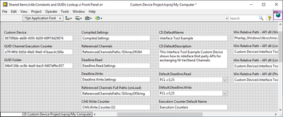

you should improve your code style in the first place. For instance good practice is to create a single global variable which stores property names for your Custom Device as a default values of a subsequent string controls. For example like here:
You can then use this global variable to define property name when reading/writing property values across your Custom Device. Likewise it is done on this example:

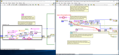

Back to your original question, there are two critical failures in your RT Driver:
1. You have typo in the "visa resource name" property name
2. Instead of providing VISA resource name from your configuration you pass empty string to the hardware initialization
