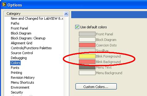

Thanks Greg.  I'm aware of the boolean property to turn the blinking on/off.
I'm looking for a way to set the blink colors (background and foreground) at run-time (i.e. programmatically).
It seems like the only place to set these properties is during edit-time in the tools>options>colors menu:

Thanks again Greg.  This still doesn't quite do what I am looking for.  I want to change the blinking color, not the [true], [false], [true to false], or [false to true] colors.
Attached is an example of what you were thinking of.  Click the blink button and notice the current (and default) blink color is yellow, while the button colors are red, green, blue, and magenta.
It is this blink color, that you can change in the LabVIEW tools>options>colors dialog that I'd like to change programmatically at run-time.

If you change the blinking colors there is a line like "blinkFG=006666FF" added to the Labview.ini file. If there is a way to reload this file it should be possible to programatically edit it before reloading. Otherwise I don't see a way to access the Labview API to change the setting in memory.
This is interesting: http://wiki.lavag.org/LabVIEW_configuration_file/Colors

Intersting Challenge.  I could not figure out a simple and elegant way of solving this problem.  So instead I used "old school" LabVIEW programming and a brute force method to accomplish the same effect.  In short don't use the blink property instead simply change it's color back and forth.
There is an example program in the NI Forums that uses the OpenG libraries to seemingly do exactly what you are asking for.
Message 9 of 14
(20,749 Views)
Changing the control color using propery nodes may not work if using Dialog controls/indicators.  Alternate brute force method, use property node to toggle items visibility (especially if everything but text is transparent).
