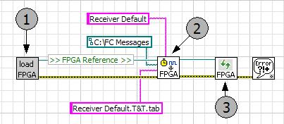

(1) I have an FPGA with 3 or more different clock domains
I wish to load it and start it running.
This will, among other things, generate a 25 MHz clock
for my unit under test. I do not want to stop or abort it.
(2) Here I set a score of parameters for one part of the FPGA.
The settings come from a Tab delimited text file.
These are timing settings for a single cycle timed loop.
(3)  Here I send a binary bit to a FIFO which acts as an occurance or notifier to run the aforementioned timing.
(1) I wish to do this sequence of operations from TestStand, where this would be done once in Setup,
(2) ... this would be done occasionally perhaps at the start of a sub-sequence,
(3) ... and this would be done frequently once for each measurement
My problem is with passing FPGA references:
I have tried using strict typedefs, Globals, functional globals, and the FPGA "Upcast" function.
In every case I have had to right click on the input or output control and directly tie it to the desired FPGA Bitfile.
If that is indeed necessary, then I see no way to keep the sub VIs generic.
If I try to pass the reference by any means so that I can run the third sub VI independently
(out of the context of this the main VI) it does not work. The reference is invalid or closed.
I may as well use "Open FPGA VI Reference" and "Close FPGA VI Reference" as needed inside each sub VI.
The only difference would be that the first, above, is the only one to have the "Run" box checked.
These sub VIs would not be generic. They would be tied intimately with the FPGA bitfile they are using.
Has anybody had particular experience passing FPGA references?

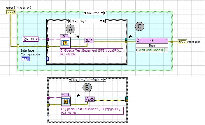

After some discussion with NI I have discovered how to use the FPGA Up Cast function.
This is the way Up Cast is meant to work. The clip below may be blury but the functions are simple.
Wire A and B are substantially different because they are typed to two different bitfiles.
If wired to the same output C, one or the other would become broken.
Upcast makes them generic enough to do that.
However for my application it will not work because -
Up Cast is not supported for FPGA VIs with multiple clocks on the block diagram.
I must use my previously discussed workarounds.
