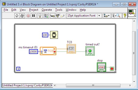

Hello wv,
Thanks for your post. I wanted to see if I could add a bit more information about why WSN I/O Variables are designed the way they are. We have customers that have very large sample intervals, I.E hours, days, weeks. We didn't want to add an abritary time-out and have aditional processing to handle this so the time stamp was added for users to use to corolate time. There is a way that you can add your own time out however. You can right click on your variable and add a "timeout". This will allow you as a user to set a time out and a boolean output will go true if a new value has not been updated in this time.
This should give you 2 optioins, checking the time stamp of the variable or using the timeout feature of the I/O Variable
Let us know if there is anything else we can do.

Corby,
Thanks for your comment.
I had tried the time out, but it would for some reason time out before what I specified it to be. Now the relative time stamp is reliable enough for me to detect loss of signal, so I am good to go.Smiley Happy
