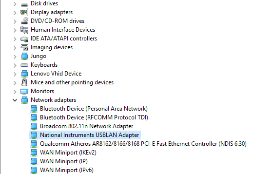

YES. A USBLAN adapter shows up in Netowrk Devices but not myRIO.
Does it show up as an unidentified device, or does it show it with the driver installed?
No it doesn't. A USBLAN network adapter shows up in device manager.

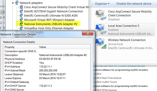

What do the network settings look like for the USBLAN adapter? Here's what it looks like for me (with a 9066, but it's very similar for the myRIO I believe):
Perhaps you have an issue with Windows / IT / Corporate / University Firewall blocking the communications between your computer and the myRIO?

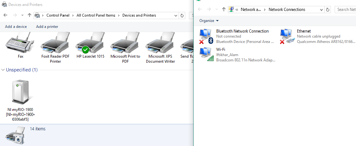

Well I do see USBLAN under Network Adapters in Device Manager but I don't se this guy as a Local Area Connection in Network and Internet>Network Connections.
And also I see myRIO as Unspecified under devices and printers.
