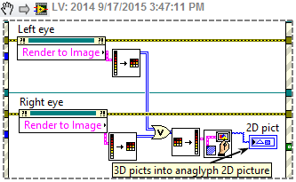

To create the Anaglyph images, the Render to image invoke node is used to extract a 2D image of each of the two 3D picture controls. The color array is then extracted of each of the 2D images and the arrays are "ORed", and then converted back into an image and displayed into a 2D picture control (see picture below).
Extracts 2D images from 3D picture controls and combine them into a single 2D pict.
