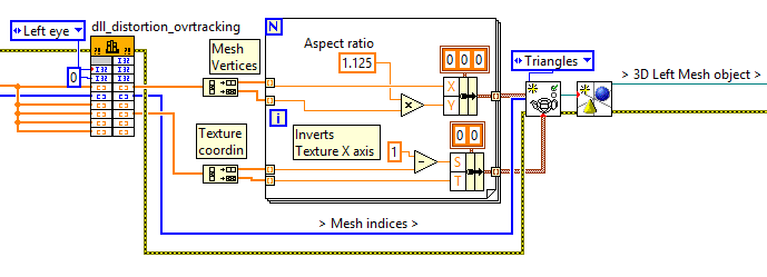

Using a DLL developed for communications between LabVIEW and the Oculus SDK, two coordinates are obtained, Z being set to 0, and two texture coordinates for each vertex of the meshes, and a series of indices giving the order of the vertices to form the triangles of the meshes. Below is shown the LabVIEW code to produce one of the mesh and how the texture coordinates are applied to the mesh. The aspect ratio given to the mesh is equal to the aspect ratio of the display of the Oculus Rift (1080 in Y divided by 960 in X = 1.125). The meshes are originally scaled in the X and Y direction between -1 and 1. The texture coordinates are also inverted relative to the X axis and it is corrected by subtracting the X coordinates from 1.
LabVIEW code to generate the left mesh.

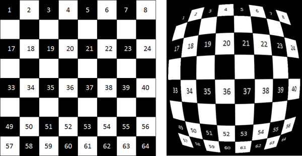

Once the mesh is created along with the texture coordinates, images can be applied to the mesh using the Apply Mesh VI from the 3D picture tool set. An example of projection of one image projected on the mesh as texture is shown below.
The image on left projected as texture on one of the meshes (right). The aspect ratio of the mesh is 1.125.

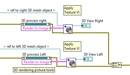

This approach of using textures on meshes to correct for distortions means that the 3D object handling must be done for 3D picture controls different from those used for outputs on the Oculus Rift. Two 3D picture controls are therefore put on the front panel of the same VI used for the right and left 3D picture controls showing the meshes but in a hidden area of the front panel. Those two picture controls are called 3D process right and 3D process left. Making these controls invisible or in the back of the 3D View picture controls does not produce consistent results. Another option is to use the "Setup Window" VI to create two hidden windows to render the 3D scenes. However, with the "Setup Window", the "Render Image" step is significantly slower than when using 3D picture controls, to the point of making the real-time operations impractical.
The 3D objects handling and camera positioning is done for the two process 3D picture controls. Images are corrected by obtaining 2D rendered images using “Render to Image” property node. The obtained images are then applied to the mesh using the “Apply texture” VI as shown below.
Rendered image applied to texture.
