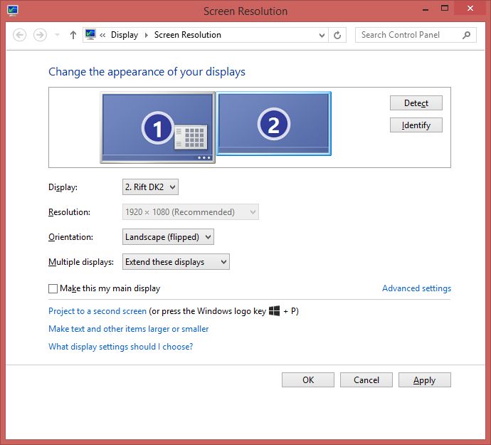

  • Windows should then detect the presence of a second monitor. Open the monitor configuration utility on your computer. Notice that the Rift must be the second monitor (unless it is the only monitor).
  • Depending on the configuration of the computer, the headset might be configured as a portrait monitor. It is then necessary to change its configuration to “Landscape (flipped)” (as shown in the figure below).
