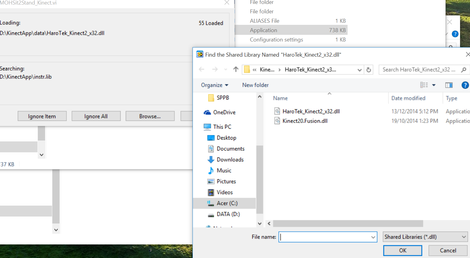

Thanks for the great Library, it make LabVIEW program  with  Kinect easily.
But I have a problem in creating the exe together with Kinect driver. Somehow I can’t get the exe running without some intervention.
System Use:
Windows 10  (64bits OS)
LabVIEW 2015 (32 bits version)
Kinect One
I did included the Kinect driver in the build’s data directory. But somehow the exe can’t locate it.

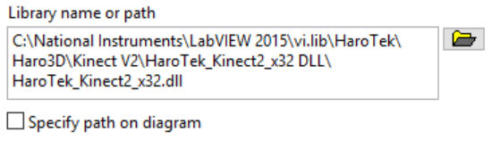

I did search on the web and found a suggestion, which is to remove the dll from directory and make LabVIEW search for the path itself.
But it still don’t work(Can’t find the dll automatically).  I have to manually search for the dll when prompted..
After clicking the dll, than the exe run without any issues.
I have check the call library node in the Kinect VIs , all point to the right path.
Just wondering what have I missed out/did wrong.
Hope can get some help or advices here.
Thanks You and Have A Great Day !
