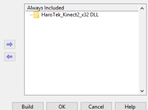

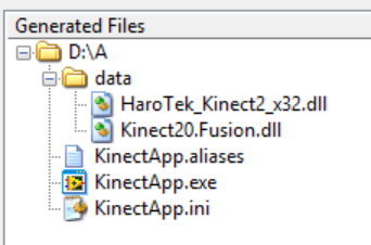

This .dll problem generally occurs when the Kinect20.Fusion.dll is not explicitly included with the build. In the "Source Files" category of your Build Properties, add "Kinect20.Fusion.dll" to the "Always Included". Make sure to select the version of "Kinect20.Fusion.dll" that corresponds to your LabVIEW version (32 or 64 bits). There are two .dll's, one for each version, and they have the same name but are not the same file.
You can also fix the problem by manually copying the correct version of Kinect20.Fusion.dll in the same directory than the HaroTek_Kinect2_x32.dll of your executable (typically the \data directory).

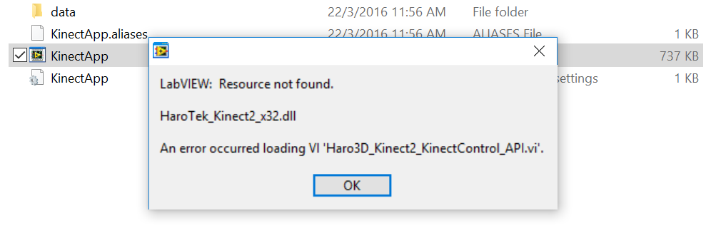

Thank You Marc for your reply,
I'm using version 1.0.
LabVIEW 2015(32Bits)
Window 10 (64 bits OS)
I have tried both the methods you mentioned but it still give me the same problem.

Hi Owk,
You should only put Kinect20.Fusion.dll in "Always Included". If you put the whole directory, or if you add the other dll, you will end up with 2 copies of the HaroTek dll, which creates the same dll. problem. The resulting compiled executable cannot be fixed by copying Kinect20.Fusion.dll.

Hi Marc,
Did I missed out anything ?
I still get the same error message while trying to run the exe.
But it works after i tried one of the method from the ni forum. ( By the specifying the path to the dll from the Call Library Function Node).

Sorry Marc,
Regarding the last sentance of my last post, it work on calling the DLL (no more pop up), but there was an error out from the Call Library Function Node.
