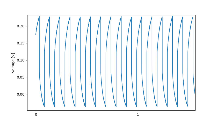

I'm using a NI USB-6210 via the Python nidaqmx API. I've set up a differential input on ai0 as follows,
acquisition.ai_channels.add_ai_voltage_chan("Dev1/ai0", terminal_config = constants.TerminalConfiguration.DIFFERENTIAL)
acquisition.timing.cfg_samp_clk_timing(rate = 10000, sample_mode = constants.AcquisitionType.CONTINUOUS, samps_per_chan = 1000)
I can provide the whole code if needed.
I have ai0 connected to the output of an AD9388 signal generator that is set to a 10 Hz square wave, 0-5V and ai8 connected to GND.
When I scope the output of the signal generator I get a 10 Hz square wave, 0-5V but when I acquire the same signal with the NI USB-6210 I get the following,
The frequency is right but nothing else. What am I doing wrong here?
