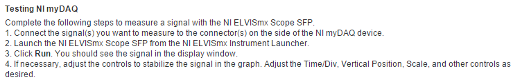

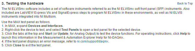

Unfortunately the link you posted, again didn't work for me. I did try to do a bit of work on my own to ensure the NI myDAQ is communicating with the computer. I found this page; http://www.ni.com/tutorial/12964/en/#toc1
I then tried the two steps mentioned. The test in the first step completed successfully however the oscilloscope software wouldn't open for the second step. It froze with the same loading bar as the Digital Multimeter...
Step1
Step 2
