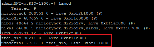

I have been asking questions about this for sometime around the forum. I tried everything possible. Let me tell you where I stuck. I followed the tutorial. NI Linux-RT can detect the FTDI. And ASRL3 showed up in the NI-Max. But the status shown is "Not Present" and VISA can't has access to it. So after asking in the forum, someone suggests that, this happened because NI Linux-RT occupied the device. I have to free the device from linux. So,  demodule the ftdi_sio and usbserial from Linux. After that NI-Max can detect the device, but alas, as a Raw USB device.

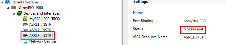

Yes I used putty. That's how I came to know that NI linux was able to detect my device. The link you gave, I already passed that point. Linux already detected my device.Problem starts after that. Labview can't get hold of that device. It says, the instance is not available. I also did follow the tutorial, where the author explain how to introduce the device to labview. Then it did show up in labview, but with status "not present".

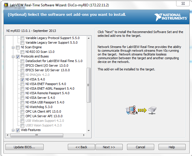

Hi fahad80,
I double checked to see if NI-VISA is compatible with the myRIO and it seems like it is.  Install this onto the myRIO and let me know if that changes anything.

3) Then followed this tutorial. And it showed up in NI-Max, again with "Not Present".

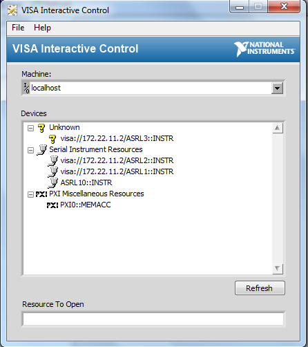

4) Even in VISA Interactive Control, it shows up with a yellow question mark.

1.) Make sure that you have the NI VISA USB Passport install onto the myRIO (I realized I didn't have it checked in the image)
