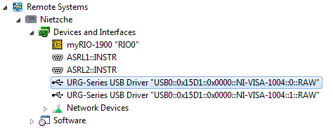

I've managed to successfully increase the level of visibility of the URG-04LX module within MAX. Originally, it was being treated as a generic 'ASRL3::INSTR', but with some tweaking I've managed to acquire a full reference to the specific device instance. In fact, I've managed to grab two! Smiley Very Happy This is shown below.

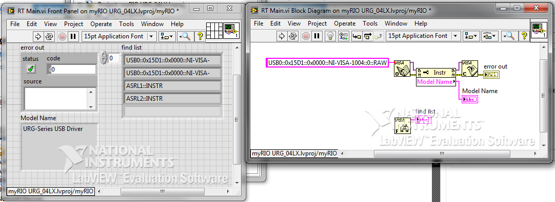

At this point, I'm not able to directly acquire a reference within the VISA resource list within LabVIEW, however I can directly interface the device via a string constant:

I've reformatted the myRIO back to the standard driver implementation plus all extra NI-VISA (5.4) additional drivers such as the NI-VISA USB Passport. Turns out that after all this debugging, all you need to do to get a Communication Device Class (CDC, ttyACM) module to get recognised within LabVIEW RT is to perform the following:
  1. Get your LabVIEW RT remote target visible in MAX.
  2. Connect the USB module you wish to control to the USB host port of your remote target.
  3. SSH into LabVIEW RT.
  4. Double check that the device you're using is a CDC. You can do this by typing the command #dmesg,and getting a response that looks something like this:
    [  173.342694] usb 1-1: new full-speed USB device number 2 using xusbps-ehci
    [  173.635010] cdc_acm 1-1:1.0: ttyACM0: USB ACM device
    [  173.652955] usbcore: registered new interface driver cdc_acm
    [  173.652977] cdc_acm: USB Abstract Control Model driver for USB modems and ISDN adapters
    Your actual response my vary slightly.
  5. Execute the command #rmmod cdc-acm. If the command prompt returns does not return with a response, the device driver has been successfully removed.
  6. Go into NI-MAX on your host machine and refresh the Devices and Interfaces list for your remote target. The hardware should now show up. Smiley Tongue
