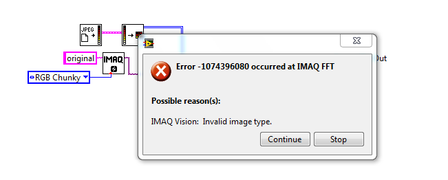

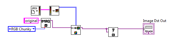

Unfortunately, I am failing at the first step: transforming it to the Fourier domain. This is my code:
When I try to run it I get this error.
Anyone have any ideas to fix this?

I found a Knowledge Base that possibly will help you, check the following link: https://knowledge.ni.com/KnowledgeArticleDetails?id=kA00Z000001DbuVSAS&l=en-US
One more thing.. I do not see anywhere assigned path to get the image, which in future will throw an error for sure.
