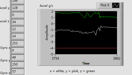

thx very much for sharing this vi! it helps alot! but do you know why i can't get the date from y accel? Thanks.
Message 10 of 31
