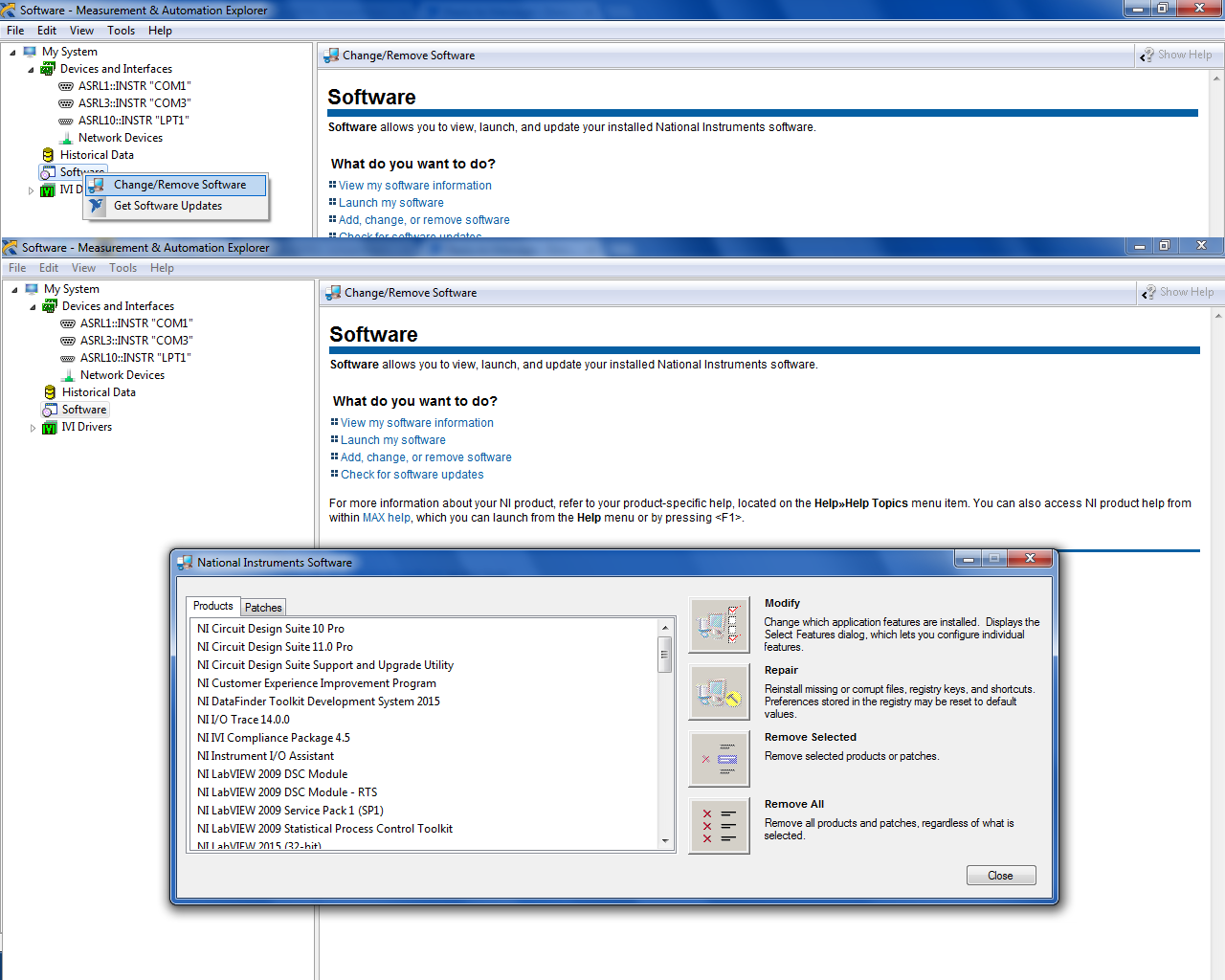

@mrneubs wrote:
It seems there is something missing from the installation on my laptop.
Try to insert the MYRIO DVD and try to repair your installation. Open NIMAX go to Software and right click on it ---->select Change/Remove software
you will get a popup now select the MYRIO software and Click on Repair. See to the below image for details.
If this doesnt work you have to Uninstall the Software and install it again selecting all the needed parameters.
