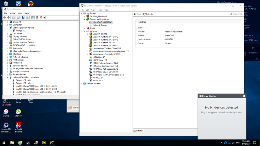

Hi guys,
I have a problem with myDAQ device. I have already installed LabView 2013 32bit with all driver updated as shown below in the NI MAX. When i plug in myDAQ, it appeared as the Data Acquisition Devices in Device Manager as normal but in the NI MAX it showed up with the USB symbol (which is supposed to be green symbol if functioning properly). And also, the NI Device Monitor doesn't recognize my device so i have no device input for the LabView VIs. My USB ports are functioning properly as i tried all of them but still came up with the same problem.
I'm using the LabView 2013 Student Edition on Windows 10 Pro and already plugged this device into 2 other computers, both worked fine except mine. I wonder if it were the loose connection of the USB cable through connection to the other 2 PCs or the device may not authorize the third computer to be regconized.

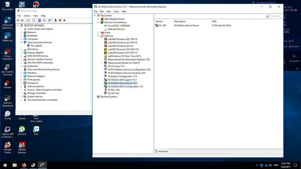

thank you for your suggestion, ZofiaK. I've already installed the lastest DAQmx 16.1 compatible with my LabVIEW 2013 as described in your link but it doesn't help. My CD package includes LabView 2013 and other drivers with it but i've updated some of them. Plz help me identify which one should be the problem. Many thanks !!!
p/s: the Windows Device Manager recognizes myDAQ as Data Acquisition Devices. that means the USB cable is still fine, isn't it?

Hi protocoled, I have already tried resetting the NI MAX configuration settings before but it's still the same. Also, I tried all four USB port on my laptop but of no use. The other two laptops worked perfectly with this myDAQ at the very first installment. I wonder if I should reinstall my Windows as the final solution perhaps. Thanks all !!!
