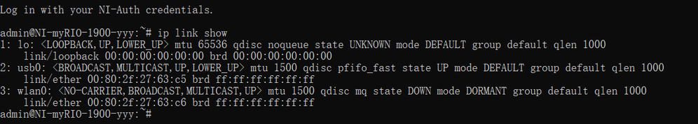

I tried to use ssh, and it show me this
I can use "iw dev wlan0 scan", but when I try to use "ip dev wlan0 set up", the device still down and I can't link it with anything.
